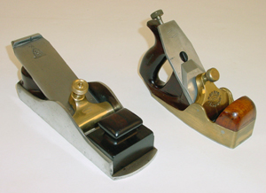

This Norris recently sold for ?1200.

Shawn, Todd, how about these two, at the same sale:
The number 11 rosewood infil went for ?3600, and the coffin smoother with walnut infil was cheap at ?1000!

The Norris, Spears, Mathieson and other infill planes I have bought on eBay, not at auction. Because I prefer used, I look for planes that may look neglected but that are solidly built.
I got one that looks like the #11 above for ?40 and a coffin smoother like the other for ?25, both on eBay by just searching for infill and waiting for one that isnt too pricey. The ones that get bid up are the overpolished (strips the patina) cleaned up ones with slick pictures. Collectors who bid these up also tend to go more for the ebony or rosewood infilled planes so the same plane with mahogany infill is much usually less. I go for the ones in which the photo is poor, the metal a dark gray and poorly described For me it sometimes cost more for the shipping than the item when it comes to heavy tools from Europe.
